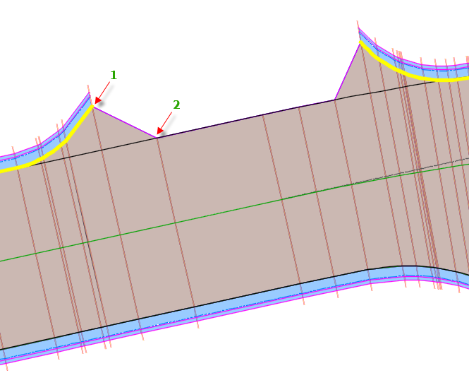

Results When Adjacent To Offset Target Start/End Setting Is Set to No
The following example shows how corridor geometry is created where there is a gap in the offset target when this setting is set to No. Note how the station at the offset target end ("1" in the illustration below) is connected to the next adjacent station on the corridor ("2" in the illustration below)

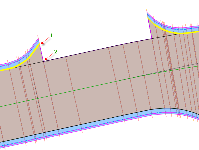

Results When Adjacent To Offset Target Start/End Setting Is Set to Yes
To more accurately represent this area, you can set the Adjacent To Offset Target Start/End setting to Yes. When this setting is set to Yes, the corridor area is created as shown in the following illustration. The offset target end ("1" in the illustration below) is now connected to the new station on the corridor ("2" in the illustration below) that was added at a small distance after the offset target end station location. At this magnification level, the new station location is not visible.

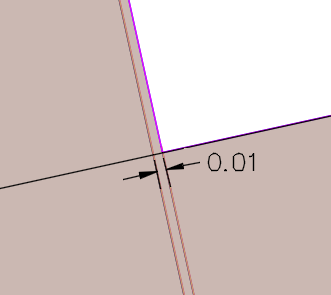

The following illustration shows a detail of the new station location ("2" in the illustration above) that was added adjacent to the end station. The offset target end links to the new station that was created at a distance of .01 units away from the offset target end, resulting in a more accurate representation of the corridor geometry.
