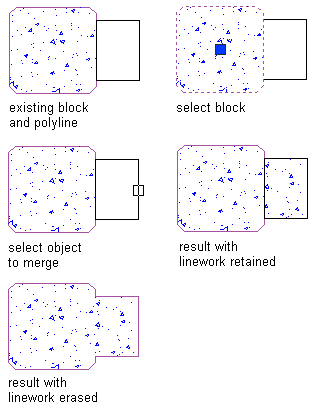

Merge contiguous closed polylines, circles, hatches, or blocks into a single closed-boundary object or linework entity.
- Select the linework or object to which you want to add one or more other linework entities or objects.
- Right-click and click
. - Select the linework/object(s) you want to merge with the originally selected linework/object, and press Enter.
- Press Enter to retain the selected linework. Enter y (Yes) to erase it.
All selected linework and/or objects are merged into a single entity.
Merging a region with a block
