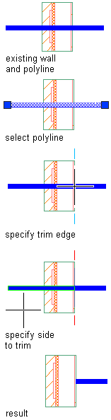

- Select the linework or object you want to trim.
- Right-click and click
. - Press Enter.
- Move the cursor over the edge or line to which you want to trim the selected linework or object.
- Click when the trim line is displayed.
- Click the side of the trim line you want trimmed.
All selected linework is trimmed to the edge you selected.
Trimming linework to the edge of a wall
