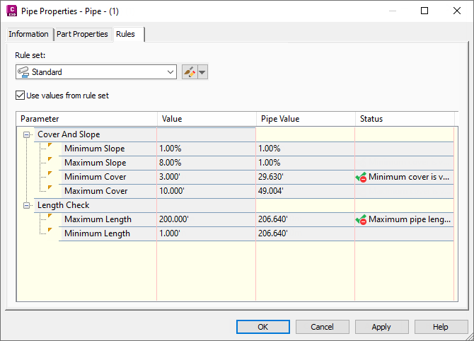

When warnings occur due to rule violations, they are displayed as warning icons in the Pipe Network Vistas (Panorama window or Toolspace item view). Rule violation information is also displayed on the Rules tab of the Pipe or Structure Properties dialog box, in the Status column. Placing the mouse cursor over the warning icon in the Prospector List View displays tooltip text describing the warning (rule violation) condition. This tooltip displays the same rule violation text that is displayed in the Status column on the Rules tab of the Pipe or Structure Properties dialog box.
The following illustration is an example of the Rules tab on a pipe in a drawing. In this example, the Minimum Cover and Maximum Length properties for this pipe display with descriptive rule violation text in the Pipe Value column because they violate the design criteria specified in the Value column. Note the rule violation descriptive text that is displayed in the Status column.
