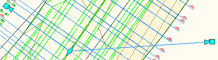

To use grips to edit a sample line
  1. In the drawing, click the sample line you want to edit.
    The sample line displays grip edit locations at each vertex.
  2. Use the diamond-shaped center grip to move the sample line to a new location along the alignment.
    The sample line slides to the new location while maintaining its relative geometry. As the sample line moves, it reorients to the underlying entity (for example, spiral, curve, or other tangents). It always remains perpendicular to the alignment.
  3. Use the square-shaped end grips to stretch (lengthen or shorten), move, or rotate segments.
    The sample line is redrawn.
  4. Use the triangular-shaped grips at the ends of segments to stretch (lengthen or shorten) each segment while keeping its relative direction.
  5. Press Esc or enter eXit to complete the procedure.
    The sample line segments are moved or edited.

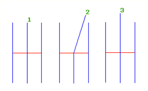

To restore a rotated sample line to the perpendicular
  1. In the drawing, click a sample line.
  2. Use the square-shaped end grips to rotate segments off their perpendicular orientation to the parent alignment.
  3. Click the rotated sample line.
  4. Right-click and click Make Orthogonal.
    The rotated sample line (1-2) rotates back to a perpendicular orientation (3) to its parent alignment, but retains the length to which it was stretched or contracted.
