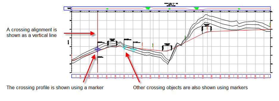

When you add crossings to a profile view, you specify which marker and label styles to apply to the crossings. You can set up unique styles for each type of crossing object so that you can display and label them differently.
Crossing alignments are shown as vertical lines in the profile view because they do not have elevations, but you can specify an elevation value for the crossing alignment labels.

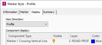

Marker styles are used to control the appearance of crossing objects in profile views. The appearance of the marker style is controlled on the Display tab of the Marker Style dialog box. Select Profile from the View Direction list to review and edit how the marker style is configured for profile view. There is a single component which controls the display of both the marker (which is used for displaying crossing profiles, feature lines, survey figures, and 3D polylines), and the crossing vertical line (which is used for displaying crossing alignments).
