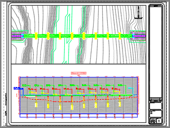

To view projected bridges on sheets created with the Plan Production tools, you must project the bridges to the profile views after using the Create Sheets command. The Create Sheets command creates new profile views in the drawing to represent the station ranges of the view frames that are created with the Create View Frames command. To display them on the sheets, the projected bridges must be projected onto these new profile views.

  3. Select the new profile view in the drawing and click Profile Views tab Launch Pad panel Project Objects to Profile View.
  4. Select the bridge that you want to project and press Enter to display the Project Objects To Profile View dialog box.
  5. Specify the bridge projection styles and label set to use and click OK.
    The bridge is projected onto the profile view.
  6. Click the sheet name at the bottom of the application window and check the layout of the profile view on the sheet.
  7. If you need to make adjustments to the profile view, click the PAPER option in the status bar to switch to model space.
  8. Click in the profile viewport and select the profile view.
