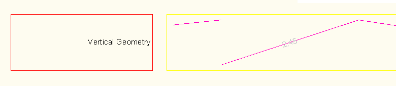

This sample demonstrates the creation of a data band style displaying the direction of slope for all segments of a profile with a title:
Dim oBandVerticalGeometryStyle As AeccBandVerticalGeometryStyle Set oBandVerticalGeometryStyle = oDocument.ProfileViewBandStyles _ .VerticalGeometryBandStyles.Add("Vertical Band") With oBandVerticalGeometryStyle ' Add graphical marks that show the uphill or downhill ' directions and the lengths of the vertical segments ' of the profile. On uphill sections the label of the ' length of the segment will be in white, on downhill ' it will be pale yellow. The graphical element that ' shows direction will be pink. .DownhillTangentLabelStyle.TextComponents.Item(0). Contents = "<[Tangent Horizontal Length(Uft|P2)]>" .DownhillTangentLabelStyle.TextComponents.Item(0). _ Color = 51 ' pale yellow .DownhillTangentLabelStyle.TextComponents.Item(0). _ Visibility = True .UphillTangentLabelStyle.TextComponents.Item(0). Contents = "<[Tangent Horizontal Length(Uft|P2)]>" .UphillTangentLabelStyle.TextComponents.Item(0). _ Color = 255 ' white .UphillTangentLabelStyle.TextComponents.Item(0). _ Visibility = True .TangentGeometryDisplayStylePlan.Color = 220 ' pink .TangentGeometryDisplayStylePlan.Visible = True .TangentLabelDisplayStylePlan.Visible = True .TangentGeometryDisplayStylePlan.Visible = True ' Modify how the title is displayed. .TitleBoxDisplayStylePlan.Color = 10 ' red .TitleBoxDisplayStylePlan.Linetype = "DOT" .TitleBoxDisplayStylePlan.Visible = True .TitleBoxTextDisplayStylePlan.Color = 80 ' green .TitleBoxTextDisplayStylePlan.Visible = True .TitleStyle.Text = "Profile Geometry" .TitleStyle.TextHeight = 0.0125 .TitleStyle.TextBoxWidth = 0.21 ' Hide the rest of the information locations and ' graphical displays. .CurveGeometryDisplayStylePlan.Visible = False .CurveLabelDisplayStylePlan.Visible = False .TickDisplayStylePlan.Visible = False End With
This style produces a data band that looks like this:
