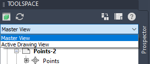

To start a new drawing or open a template from the Prospector tree
- In the Toolspace Prospector, click
Master View from the drop-down list.
- Expand the
Drawing Templates collection and right-click a template to:
