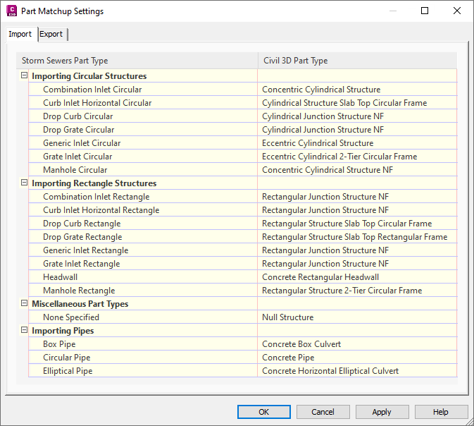

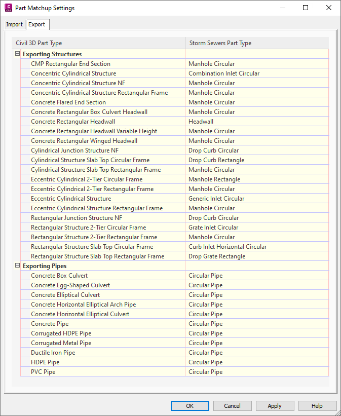

The Autodesk Civil 3D drawing templates contain proposed matching settings as follows:
Import settings:
Export settings:
