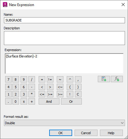

Spot Elevation Expression
With label styles, you can create and name mathematical expressions based on the components of the objects they are labeling. For example, you can create an expression for spot elevations on a surface, which subtracts a given value from the actual surface elevation. The expression could be called SUBGRADE and the composition might look something like this: {Surface Elevation}-2, where Surface Elevation is a component, or named property, of the surface.
After it is created, that expression can be used as a component for label styles and table styles. Simply create a Spot Elevation surface label style employing the expression called SUBGRADE. Use the New Expression dialog box, as shown in figure 10.
Figure 10: Surface label style expression
