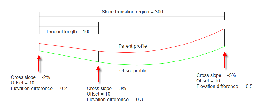

Where there is a transition region specified between one cross slope to another cross slope, the offset profile geometry is created as shown in the following example.
- The elevation difference values that are shown are between the parent profile and the offset profile, and they are determined by the cross slope and the lane width.
- The geometry point is located 1/3 of the way into the transition region, so the cross slope at the geometry point is 1/3 of the total slope transition.
- The offset profile entity will be a tangent if the parent profile entity is a tangent.
- The offset profile entity will be a parabola if the parent profile entity is a parabola. The offset parabola will use the specified K value for the offset profile (calculated prior to the slope transition being applied).
- The offset profile entity will be a circular curve if the parent profile entity is a circular curve. The offset circular curve will use the specified R value for the offset profile (calculated prior to the slope transition being applied).
- Parabolas and circular curves in the slope transition area will use the K or R of the offset profile curves that was calculated prior to the slope transition being applied.

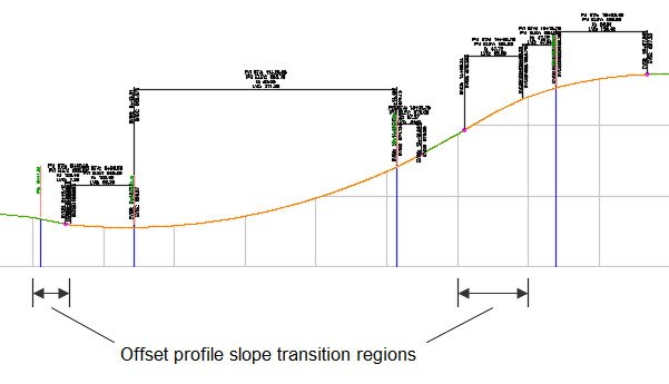

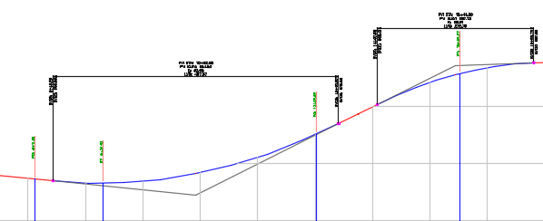

The following examples show a centerline profile (top) and an offset profile with slope transition regions (bottom).
