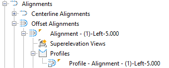

    The offset alignments are added to the Offset Alignments collection in Prospector. Offset profiles are created in the Profiles collection inside the named offset alignment collections.
    By default the profiles are dynamic and have a single cross slope value. You can add regions for cross slopes or change the update property to static by modifying the offset profile properties.
