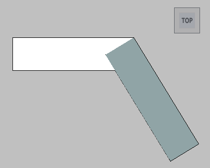

We can learn more about how Autodesk Civil 3D creates gradings by looking at some examples of grading intersection. Figure 10 shows the top view of two overlapping gradings. The segment on the left has a grade of 0%, and the one on the right has a steep grade of 100% with a cross-slope of 2:1.
Figure 10: Top view of two intersecting gradings
