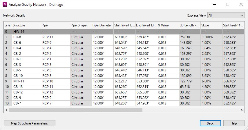

Use this page of the dialog box to review and assign values and settings for the pipes and structures associated with the pipe network.
Data Table
The table on the Network Details page contains the data necessary to perform the selected analysis types.
When you are performing an inlet analysis, additional columns are displayed.
When you click on a row, the corresponding line in the drawing is highlighted. You can access commands to zoom to, pan to, and select a line in the drawing by right-clicking the row and selecting a command on the context menu. Selecting the line selects both the pipe and the structure.
You can control the display of columns by changing the Express View setting, shown below, or by right-clicking the column heading in the table to display the context menu and then selecting the columns you want to be displayed.

    You can click the Map Structure Parameters button to open the Map Drainage Structure Parameters dialog box. You can use the Map Drainage Structure Parameters dialog box to map the parameters of Part Builder parts to parameters that are required for the Analyze Gravity Network command.
Editing Multiple Rows
To edit multiple rows in a column, hold down the Ctrl or Shift keys when selecting the rows and then keep the Shift key pressed when you click the column. If one or more of the selected items in a column is not editable (shown with a gray background), then multiple-row editing is not enabled.
When you select multiple rows, each corresponding line in the drawing is highlighted.
Note: A dash (---) indicates that a property is not applicable. A property shown in a cell with a gray background cannot be modified.
