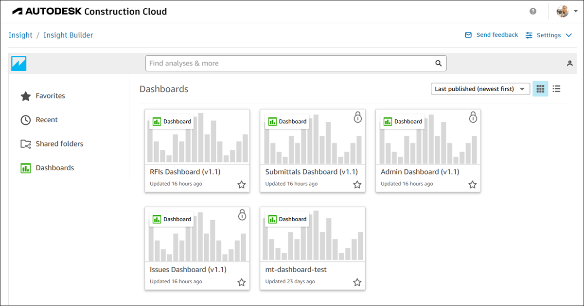

Click the Dashboards from the left navigation in Insight Builder.
Click the More menu
at the bottom right of the desired dashboard to:
Add a dashboard to a folder
See recent snapshots
Delete a dashboard

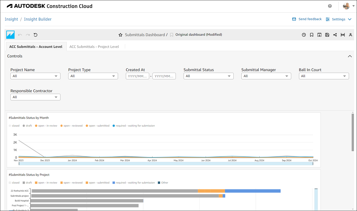

Filter, Sort, and Interact with Dashboards in Insight Builder
Use filters to limit the data represented in dashboards. For example, you can use filters to exclude specific values from certain dashboards.

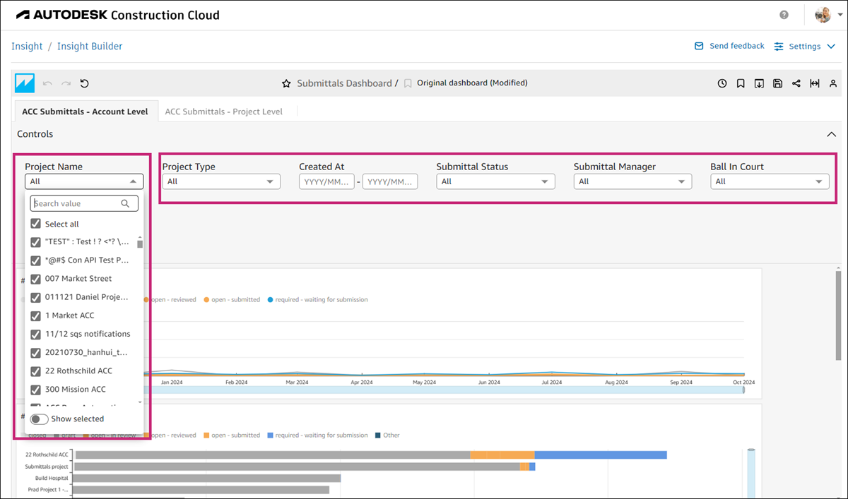

To apply drop-down filters:
Click Dashboards from the left navigation in Insight Builder.
Click the relevant dashboard. This action opens the Controls page.
Use the drop-down lists to select or unselect the values as needed.

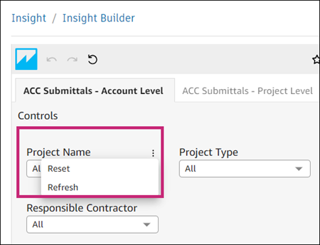

Tip: Toggle on/off the Show selected option at the bottom of the drop-down list to display all selected filters.Hover over the drop-down name to display the More menu
. Click the menu to reset or refresh the filters.
