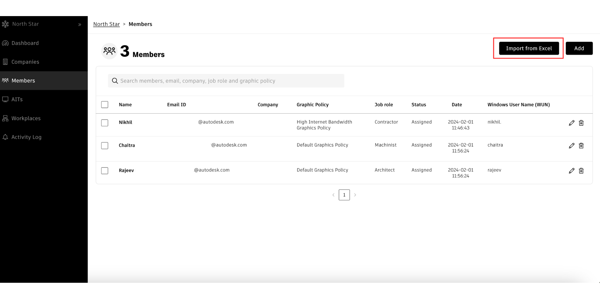

  1. Select the Members Tab and click the "Import from Excel" button on the top right. Bulk Import Members

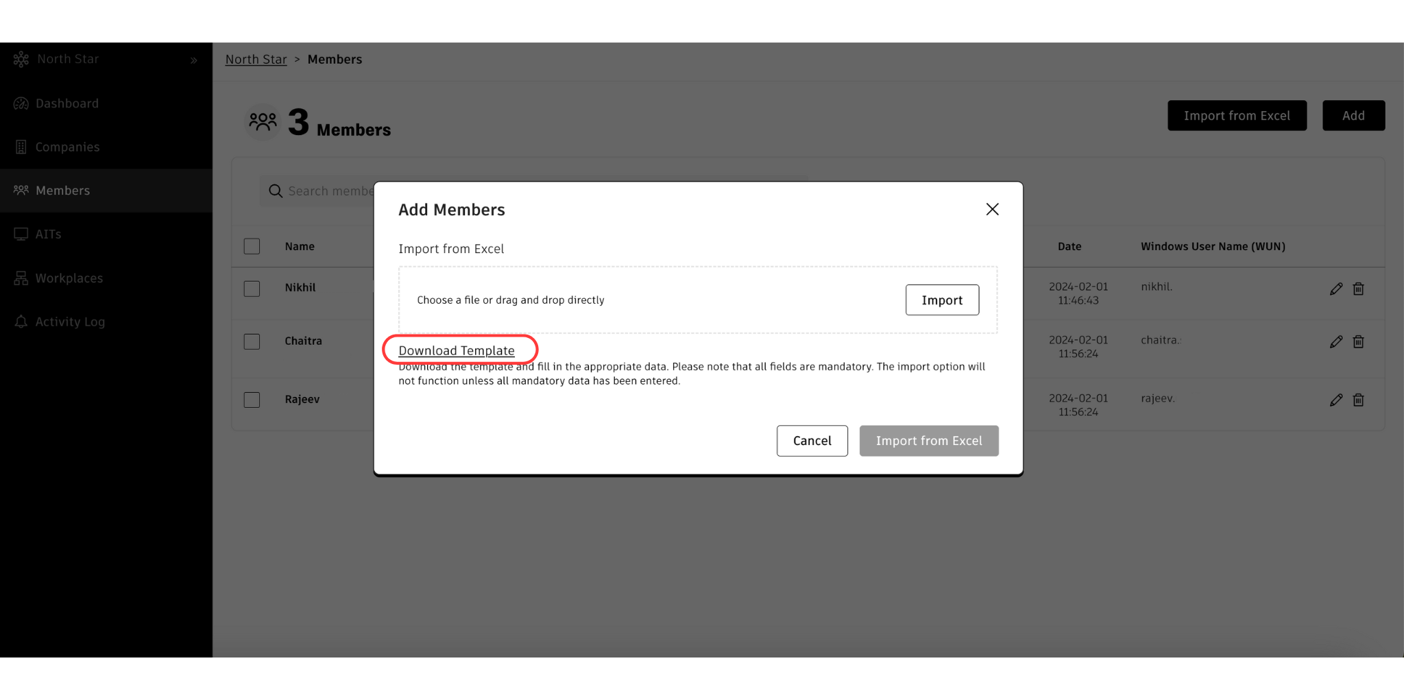

  2. Download the Excel template needed for importing members by clicking on "Download Template." Bulk Import Members

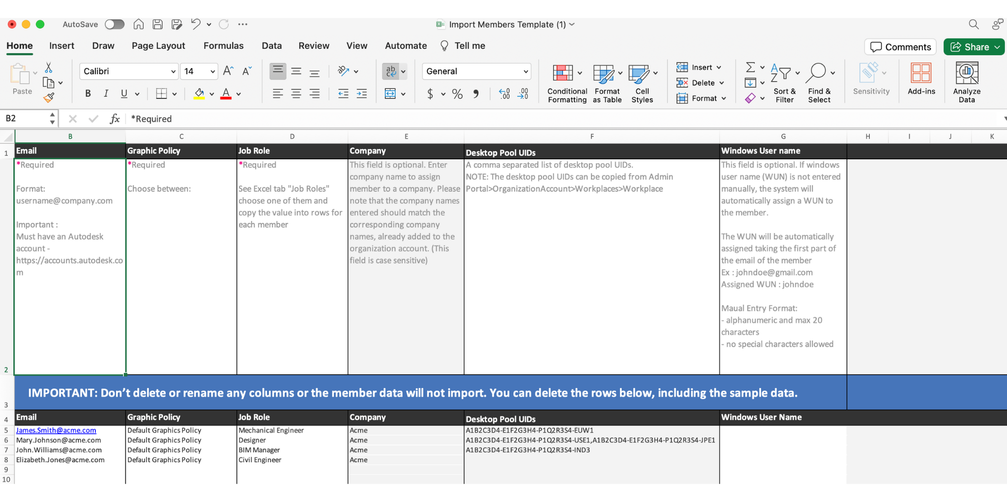

  3. Open the template on your machine and follow the instructions within the Excel template to enter new member information. Please note that Email, Job, and Graphics Policy fields are mandatory for each entry. If you already have a desktop pool created for the user, the UID can be specified in the designated area of the template. Bulk Import Members
  4. When completed, save the file on your device.

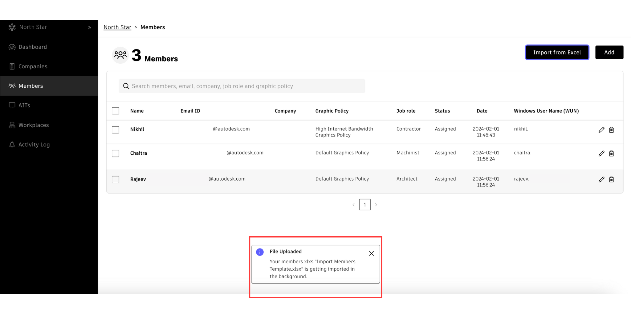

  5. Navigate back to Digital Workplace and use the "Import from Excel" option to upload your file. Upon completion, you will receive a notification indicating the status of your upload: successful, partially successful, or failed. This will inform you of the need for any further actions to ensure all data is accurately processed. Bulk Import Members
