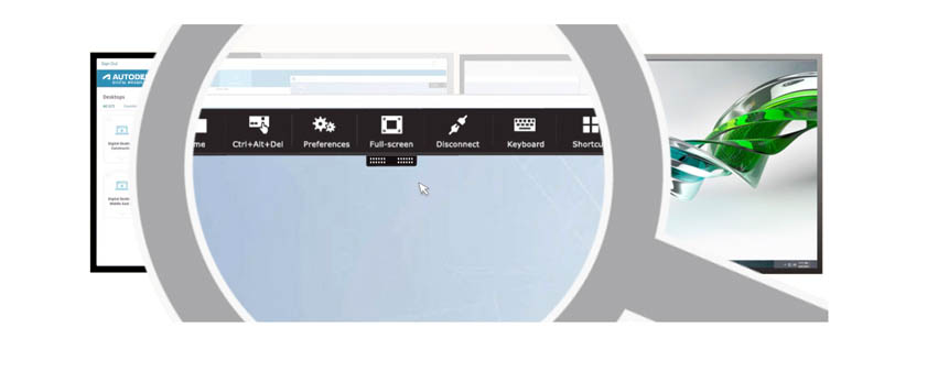

    Drop Down Toolbar
  3. Click on the Autodesk Digital Workplace drop down toolbar at the top of the screen. Select the "full screen mode" icon in the expanded toolbar menu.
    Drop Down Toolbar

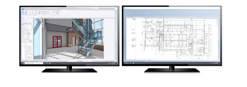

  4. Any programs opened on the Digital Desktop will now work across both screens.
    Across both screens

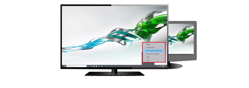

  1. In the Citrix Workspace App Settings, choose "Advanced Preferences."
    Across both screens

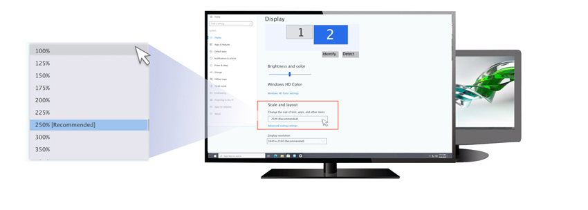

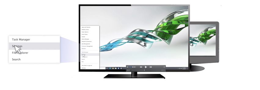

  3. Access the system’s Display Settings.
    System Display Settings
  4. With the secondary monitor selected, under "Scale and Layout" change the setting to 100%.
    Client Scaling
