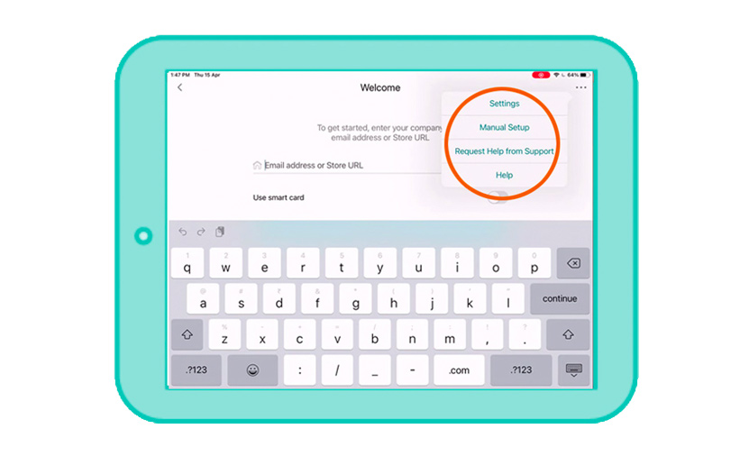

- Open the app and select "Get Started."
- Select "Manual Setup" under settings.

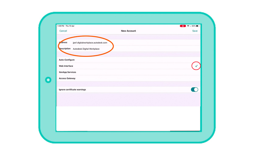

Fill out the form:
- Enter the address of the Digital Workplace User portal. The address will be different depending on your region — your Organizational Account Administrator can provide you with the URL
- in the description field, enter "Autodesk Digital Workplace"
- choose "Web Interface" and Save.

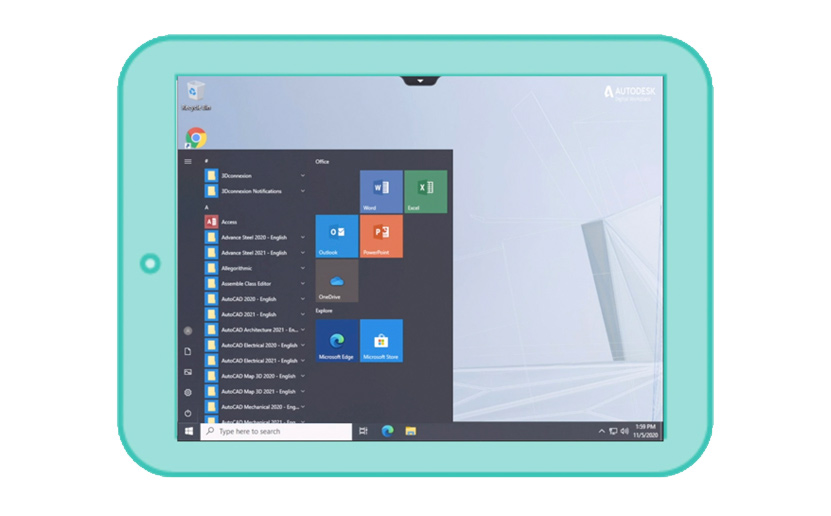

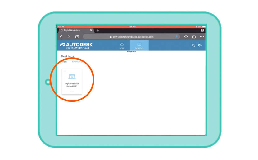

- When you have logged into the User Portal with your Autodesk account, click on the Digital Desktop icon you want to open.
- You can open any program from the Windows main menu, and it is ready to use.

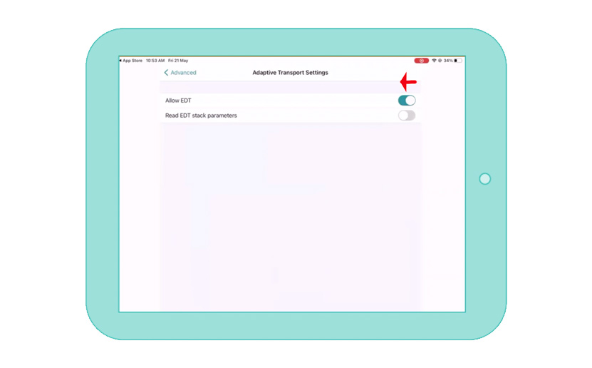

DISABLING THE EDT PROTOCOL
To ensure consistent performance, it is recommended that the "Enlightened Data Protocol," or EDT, be turned off.

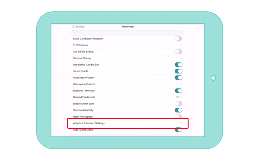

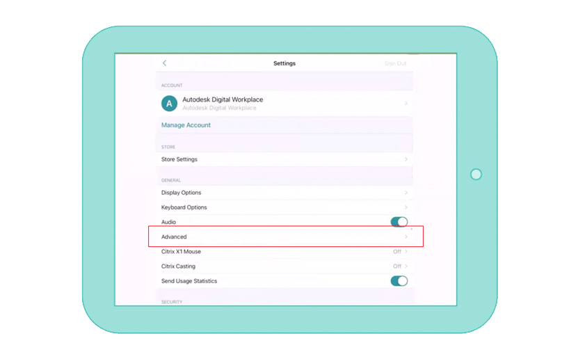

- Open the Citrix Workspace App settings and select "Advanced."
- Click on "Adaptive Transport Settings."
- Turn the "Allow EDT" button to the "Off" position.

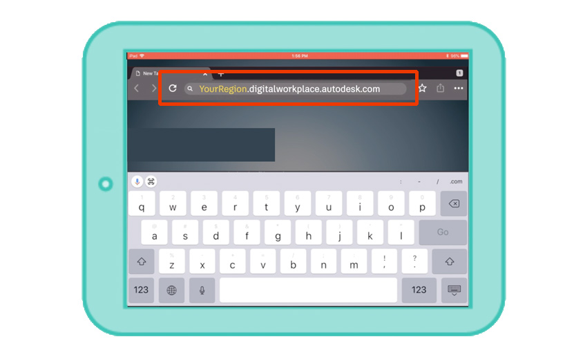

- Once it is installed on your Mac device, open the Chrome browser and go to the Digital Workplace User portal. This address will be different depending on your region — your Organizational Account Administrator can provide you with the URL.

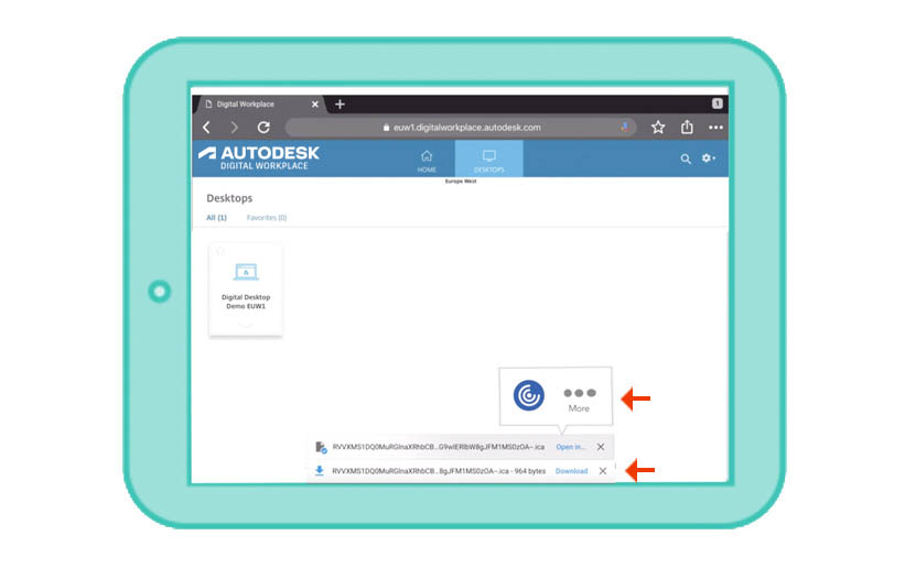

- Open the .ica file by clicking on the tab at the bottom of the screen. It will open through the Citrix workspace.
