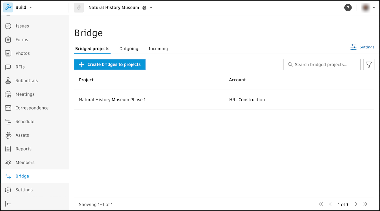

Share content with other projects
You can share the following content with other projects:
You can also choose to automatically sync the content you share. When a piece of content is updated, the updated content will automatically sync to the projects it's been shared with. All the stakeholders you've shared to have access to the most current information. Then you can manage these automations you create.
Share Bridge interface

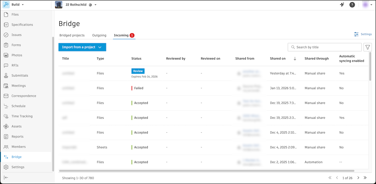

Receive content from other projects
You can view and manage the incoming content going into your project.
Incoming tab interface
