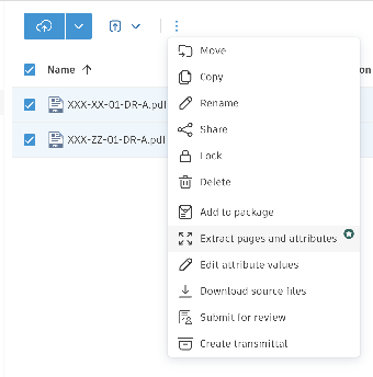

  1. Click the Files tool.
  2. Click to select single PDFs, multipage PDFs, or a mix which contain the drawings and attributes you want to extract.
  3. Select the More menu next to the Publish button.
  4. Click Extract pages and attributes.
    You'll enter the first step of the extraction process - Select Title Block Template.
