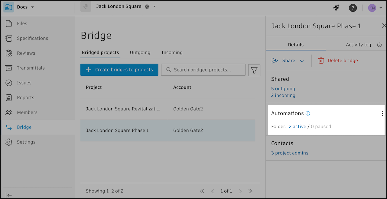

To resume, delete, or pause an automation:
  1. In Autodesk Docs or Autodesk Build, click Bridge in the left navigation.
  2. Click on a project in the Bridged projects tab.
    In the right panel that appears, you can see how many active or paused folder and sheet automations you have with this project.
    To create automations, learn how in Share Sheets or Share Files or Folders.
  3. To resume or pause all types of automations, click the More menu and select Resume all automations or Pause all automations.
  4. To manage individual automations, next to Folder, Sheet, or Team, click the relevant number of active or paused automations shown.
  5. Active and Paused automations are shown in separate tabs.
    • The Active automations tab lists your sheets or folders with active automations.
    • The Paused automations tab lists your sheets or folders with paused automations.
    In either tab, select automations and use the buttons at the top to Resume automations, Delete automations, or Pause automations as applicable.
  6. Click Done to perform the action on the selected automations.
