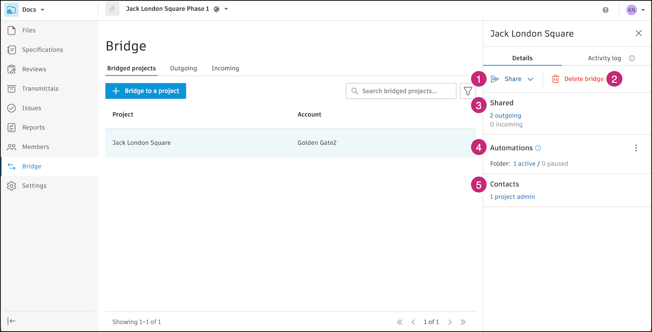

Navigate to the Bridge tool using the left navigation menu to manage your bridged projects. You can view and control what is being shared to and from your project.
Bridged projects panel
  1. Share Files and Folders to Another Project
  2. Delete Bridges
  3. Track Shared Content between Bridged Projects
  4. Manage Folder Automations
  5. View Contacts for Bridged Projects

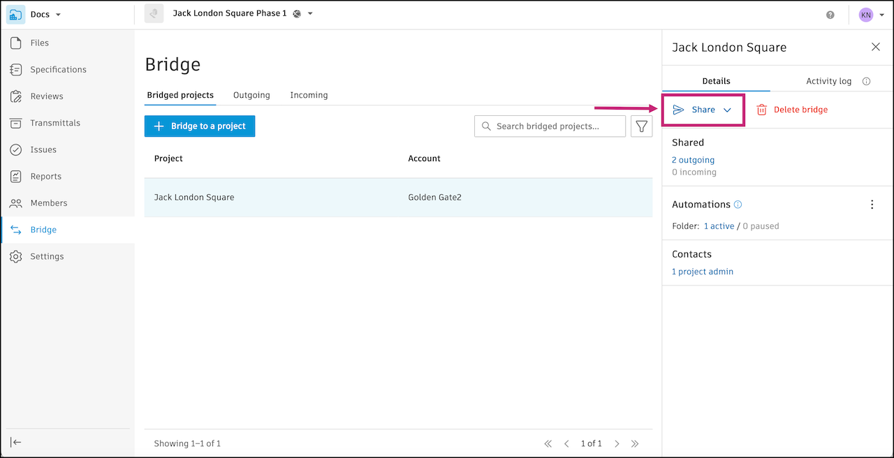

Share Files and Folders to a Bridged Project from Bridge
  1. In the Bridged projects tab, click the bridged project that you want to share with.
  2. Click Share in the right panel.

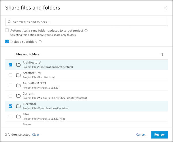

  3. Select Files and folders.
  4. Use the search field to search for files or folders by name.
  5. (Optional for folders only) Select Automatically import folder updates into target project to create a folder automation. In a folder automation, the target project receives updates when you make updates to the selected folders in the source project. This feature helps make sure that the stakeholders you shared the folders with will always automatically have the most updated files.
    Note:
    • Automations can't be created on individual files.
    • When you create a folder automation and the project you are importing from isn't bridged to the current project, a bridge will be created. The project will appear in the Bridged projects tab in Bridge and you can manage automations in the Bridge tool.
    • New subfolders created in the source folder after the initial share won't be automatically synced to the target project. You will need to share those new subfolders separately if you want them to be synced.
  6. (For folders only) Include subfolders will be selected by default. All subfolders within the selected folders will be shared. You can deselect this option if you want to only share the parent folders you select.
  7. Select files or folders that you want to share.

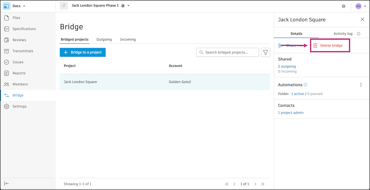

Delete Bridges
  1. In the Bridged projects tab, click the project where you want to delete the bridge.
  2. In the right panel that appears, click Delete bridge.
    If you delete a bridge, all automations to and from that project will also be deleted. Both projects will retain any information previously sent through Bridge.
  3. Confirm by clicking Delete bridge in the pop-up window.
The project administrators on both of the bridged projects will receive a notification that the bridge has been deleted.

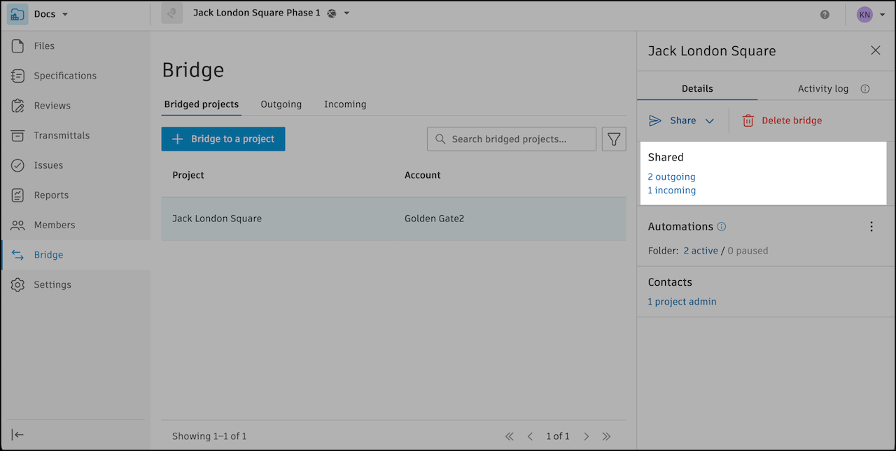

When viewing the details for a bridged project, you can navigate to a filtered view of the Outgoing or Incoming tabs to track what was shared to and from that project.
  1. In the Bridged projects tab, click the project.
  2. In the right panel that appears, under Shared, you will see the number of outgoing and incoming events that have been performed with this project:
    Bridged projects shared content

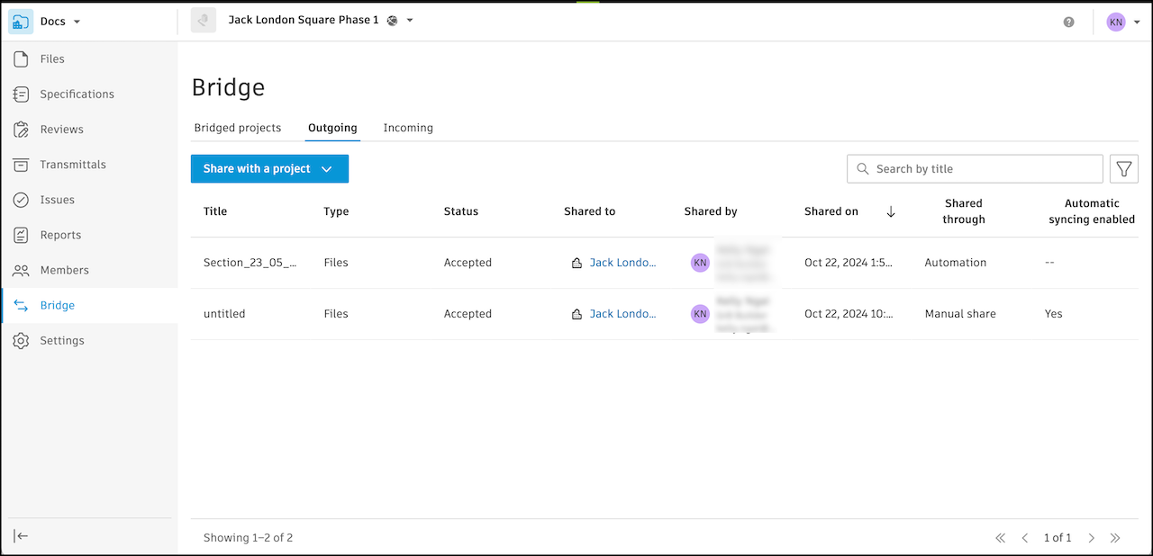

    • # outgoing: This will take you to a filtered view of the Outgoing tab. For example, here is a filtered view of the two events where content was sent to the Jack London Square project:
      Outgoing filtered view

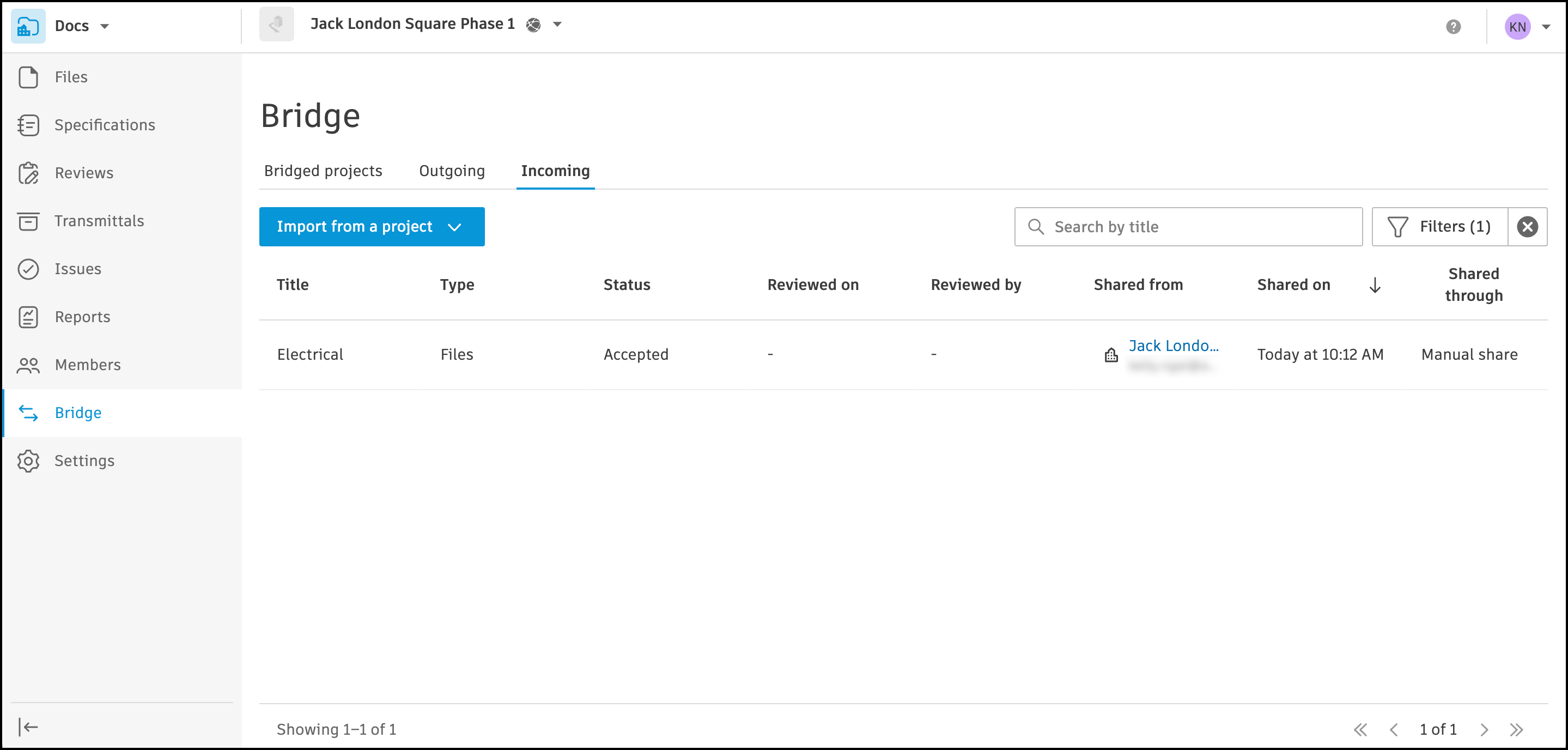

    • # incoming: This will take you to a filtered view of the Incoming tab. For example, here is a filtered view of the one event where content was received from the Jack London Square project:
      Incoming filtered view
  3. Click any line item to see the details.

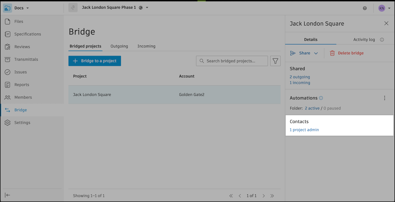

For bridged projects, you can view a list of the project administrators on the bridged project so that you can easily contact the right people on the project.
  1. In the Bridged projects tab, click a project.
  2. In the right panel, under Contacts, click # project admins.
    View bridged contacts interface
A window will open with a list of all the project administrators' names and email addresses.
