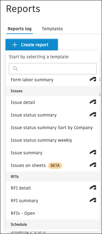

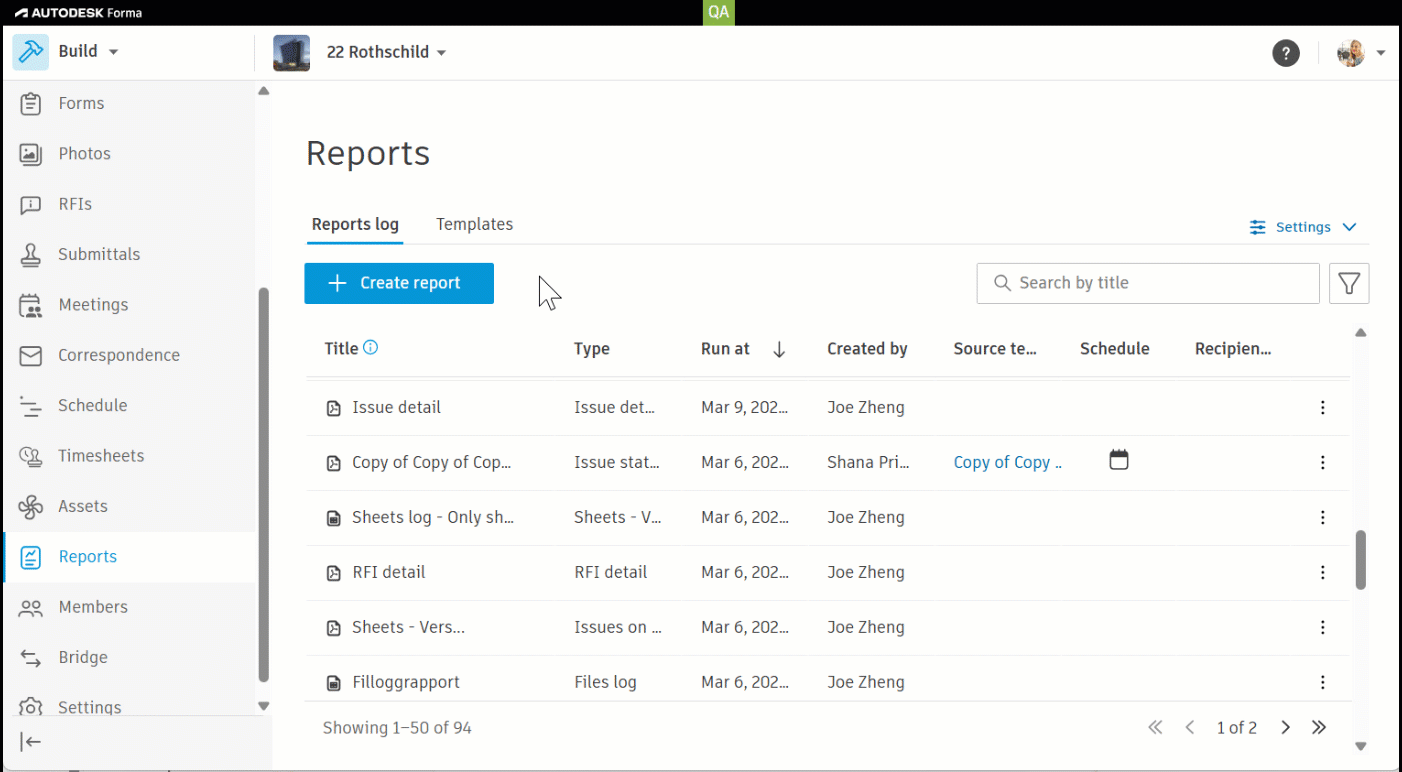

  1. Click Reports from the left navigation to open the Reports tool.
  2. Click Create report and select a report template to start with.
    Note: The Templates drop-down list shows both user-created and out-of-the-box templates. The Autodesk logo marks out-of-the-box templates.
