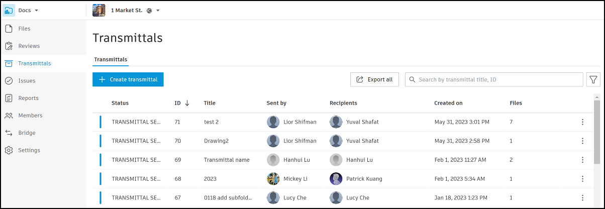

Create Transmittals from the Transmittals tool
  1. Click the Transmittals tool.
  2. Click Create transmittal.

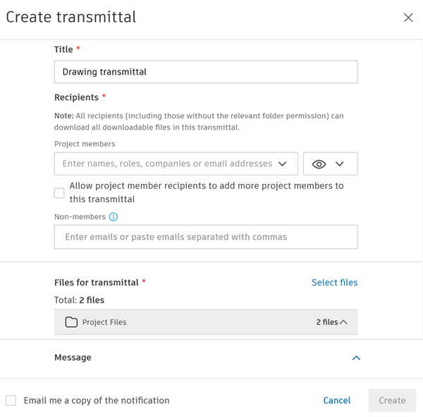

    Complete the transmittal details.
    Title: Enter a name for the transmittal.
    Recipients:
    You can add a maximum of 1,000 recipients. All recipients (including those without the relevant folder permission) can download all downloadable files in this transmittal.
    • Project members
      Click this field and add members, roles, and companies. Click Save.
      Adjust the View permissions to choose whether recipients can see other recipients of the transmittal or not.
      This setting only applies to project members. The sender and other project administrators can always see the full recipient list. After the transmittal is sent, you'll have the option to adjust the view permissions for the recipient list again from the More menu for the transmittal.
      • Allow project member recipients to add more project members to this transmittal
        Select this option if you want to allow project member recipients to add other project members to the transmittal after it's sent. See Add Recipients to Sent Transmittals for more details.
    • Non-members
      To see this option and transmit files to non-members:
      • A project administrator needs to turn on the Transmit files to anyone in transmittal settings.
      • The transmittal sender needs Create + Upload folder permissions or above.
        Click the Non-members field and enter the emails addresses of any non-members you want to share the transmitted files with.
        Note: Recipients who are non-members won't be able to view any details of the other recipients.
    • Message
      If necessary, add a Message to the transmittal recipients. The message can indicate what the transmittal is for and specify any required actions.
    • Files for transmittal
      Check the list of files included in the transmittal. Click Add files to add more files or click next to a file to remove the file from the list.
      Attribute groups: You can also add the attributes contained in an attribute group to the files in the transmittal. Select an existing transmittal group to preview and add the attributes. See Transmittals Settings for details on how project administrators can create attribute groups.
      Note: Attribute values are captured at transmittal creation time and don't change if updated later.
  5. Select Email me a copy of the notification if you want to receive an email to confirm that the transmittal is created and sent successfully.
  6. Click Create.
