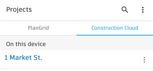

  1. Open the Autodesk Construction Cloud mobile app on your mobile device and sign in to your account.
    The app will open on the Projects page and with the Construction Cloud tab open. This is where your Autodesk Construction Cloud platform projects are listed as:
    • On this device: Projects which you've downloaded to your device and are available to work with offline.
    • In the cloud: Projects which you haven't downloaded and are therefore not available offline.
  2. To download a project to your device, tap the name of the relevant project In the cloud.

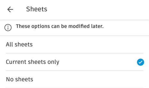

  4. If you choose to set specific options for each item, tap on each one to view the download options available. For example:
    These options enable you to download only what you need to access on your device, saving storage space. The available options are as follows:
    • Sheets:
      • Current sheets only - download only the current set of sheets, for example to get ready for your site walk.
      • All sheets - download all versions of all sheets.
      • No sheets.

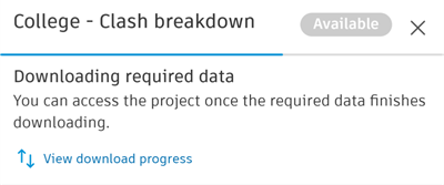

  5. Once you've selected your download options, tap Download to device.
    You can view the progress as your project downloads.
    Your project will move to On this device when it is downloaded.
