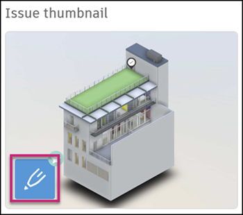

Edit Issue Thumbnail
When you create an issue on a 3D model in Files, an issue thumbnail is automatically generated from the current display of the issue in the viewer.
See Place Issues on 3D Models and Create Thumbnails to learn how to create and edit issue thumbnails.
To edit a thumbnail from the issue flyout panel:
  1. Click the link in the Placement field.
  2. In the viewer, click the pencil icon in the bottom left corner of the thumbnail to activate the markup mode.
    Viewer Markup Mode
  3. Add markups as needed.
  4. Click Save thumbnail.

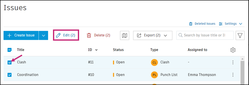

Edit Multiple Issues
  1. Select two or more issues using the multiselect box next to an issue's title.
    Bulk edit issue
  2. Click Edit to open the issue panel.
  3. Change any of the issue fields as desired
  4. Click Save
Any edits that you make will apple to the multiple issues selected.

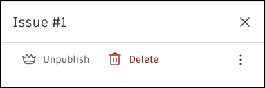

Publish and Unpublish Issues
Issues can be published or unpublished directly from the Issues log.
  1. Click the relevant issue from the Issues log.
    Once you select an issue from the Issues log, you'll be able to see if the issue is already published.
  2. Click Publish or Unpublish and confirm the action to change its published status.
    Publish or unpublish an issue
Published issues will be visible to anyone on your project with the correct permissions. If you unpublish an issue, only the issue's creator, assignee, and watchers will be able to view it in the Issues log and on the relevant sheet or model.

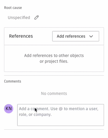

Comment on Issues
You can leave comments on any issues you have access to. Commenting gives your team a centralized place to communicate and flag information regarding an issue.
  1. Click the relevant issue from the Issues Log. A panel opens to display all the issue details.
  2. In the Comments section, click the field to type your comment. You can type the @ symbol to mention a project member, role, or company to get their attention. Type in a name or select from the drop-down menu. Only members, roles, or companies who can view are listed. The mentioned member or members will receive a notification when you submit your comment.
  3. Click Submit.
Tip: The ability to mention others is available to all members that can comment on issues.
Add comment
