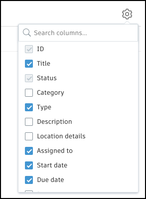

Add extra columns to the Issues Log by clicking the gear icon on the upper-right corner of the Issues Log. Once you select a new column, it will appear in the log immediately. Use the search bar to quickly find the column you'd like to add.
Add columns

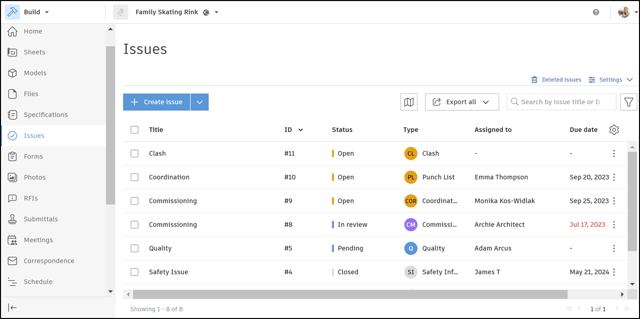

Filter Issues Log
To filter the Issues Log, click the Filter . This will open the Filter flyout. Configure the filter or filters that you want to use, and the Issues Log will update automatically.
Note the following:
  • You can clear filters individually or clear all applied filters by clicking Clear all or X next to the filter icon
  • Click Reset to return to the default view which includes all issues except closed and deleted ones

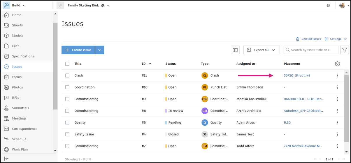

Issue Placement
The Placement column in the Issues Log contains a link that allows your team to quickly access the issue markup.
Search issues
Click the link in the Placement column to access that sheet or file. The link will always take you to the latest version of that sheet or file.
Note: If an issue markup is on a previous version, the Placement link does not take you to the previous version. You will have to navigate to the previous version within the viewer to see the desired issue.

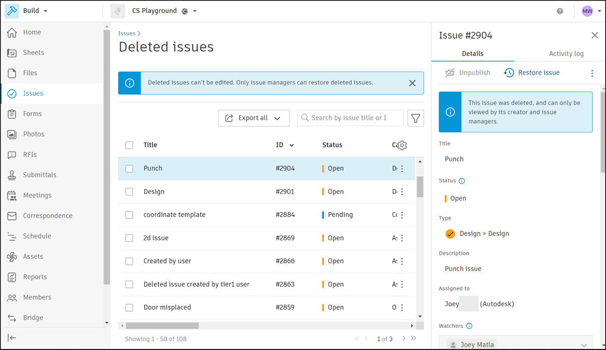

View Deleted Issues
Project members with View, edit, and assign and Full visibility permission can view the deleted published and unpublished issues they'd originally created. Members with Manage issues or Administrator access can view and restore all published issues that were deleted in a project. In addition, they can see unpublished deleted issues if they're an issue watcher, assignee, or creator.

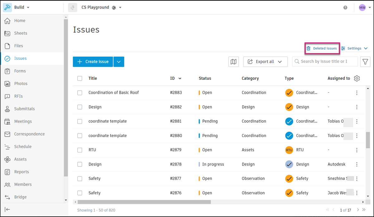

To view deleted issues, click Deleted issues at the top-right corner of the Issues Log. This action opens the Deleted issues area.
Note: Deleted issues can't be edited.
To view the details of a deleted issue, click this issue from the Deleted issues area. A flyout panel opens to display all the issue details.
See Delete and Restore Issues for details about deleting and restoring issues.
