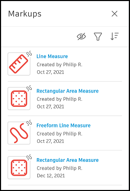

You can click individual markups created on a 2D file to view relevant details. You can also use the markups list view to detail all standard markups created on a file in one overview.
Note: The list view does not include the issues or photos feature markups.
  1. Click .
    All the markups created on the file will be listed along with the page the markup appears on, type of markup, the member who created it, and the date it was created.
  2. Click a markup in the list to select and highlight the same markup on the file.
    Note: You can also bulk select and edit markups from the list.
  3. To hide or unhide all markups, click .
