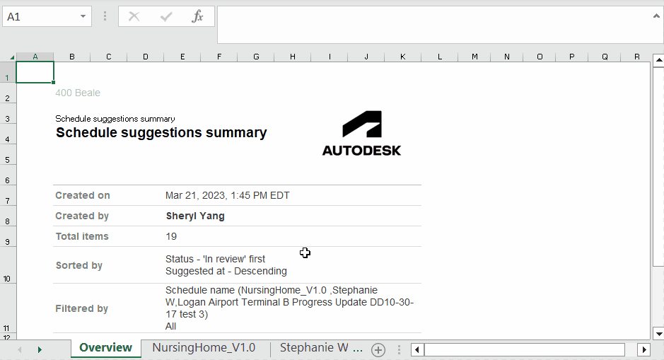

Example of a Schedule Suggestions Summary Report
