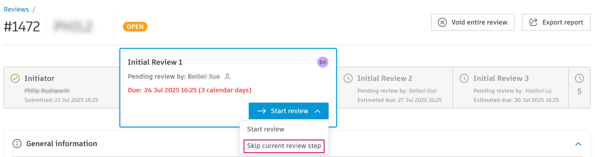

Skip a Single Review
Open the review requiring the step skip.
In the workflow bar, click Skip current review step.
In the confirmation dialog:
- Review the step change details.
- Add optional notes.
- Click Skip to confirm.
In the Send email notification dialog, choose to Send notifications or Skip without sending.
