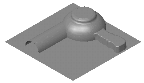

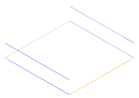

The blow-dryer uses a ruled surface as a parting surface in the model. The two curves (lines in this case) are drawn along opposite sides of the stock and are then translated down in Z to the appropriate depth.
Then they are selected as the two curves for the ruled surface which passes under the other surfaces of the model to the extent of the part so there is a complete surface for use in the mold.
