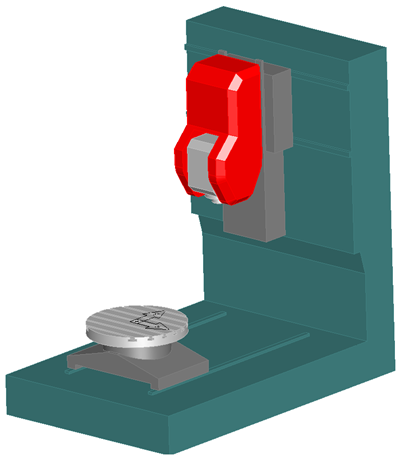

The second stage of building your MD file is to set which solids work in which axes, using the Specify Movement dialog. You can define both rotary and linear axis movements for all types of machines, from simple 3-axis milling machines to full turn/mill machines.

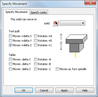

In the following example, the z_slide solid is selected.
Given that this solid moves in the Z axis, the option Moves +delta Z is selected in the Tool quill section.
If this were a Z motion on the table instead, we would select the Moves -delta Z option in the Table section.
Although this component also moves in the X axis, that is not selected because the solid behind it controls that movement that relates to this solid when we set our parent/child relationships.
