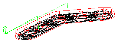

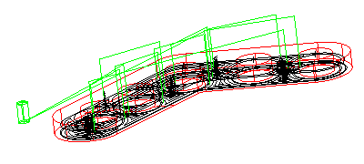

Minimize tool retract
This example shows normal retracting.
This is the same example with Minimize tool retract enabled.
Setting this attribute can result in more slot cutting. Study the toolpaths carefully before cutting.
This feature is helpful for 2-axis mills.
If Minimize tool retract is selected, the setting for the default attribute, Min. rapid distance, is ignored. The tool does not retract unless to prevent gouging.
This attribute only affects how the tool retracts within a single operation. It does not control how operations are ordered. For this functionality, see Min. rapid distance.
