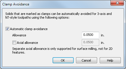

To open the Clamp Avoidance dialog, click the Clamp avoidance button on the Milling page of the Machining Attributes dialog.
Automatic clamp avoidance — Select this option to automatically avoid solids that are marked as a clamp. To mark a solid as a clamp, right-click its name in the Part View and select Use Solids as Clamp in the context menu.
Note: This option applies to 2.5D NT-style toolpaths and 3D toolpaths. You must use NT-style toolpaths for both the Rough and Finish operations to use this option for a 2.5D part.
Allowance — Enter the minimum distance that you want to leave around clamps.
Axial allowance — To set separate axial and radial allowances, select this option and enter the minimum axial (XY) distance that you want to leave around clamps. If you enable Axial allowance, the Allowance value is applied to the radial (Z) distance only.
For 2D features, the Axial allowance is ignored, and the Allowance is used as the radial and axial allowance.
