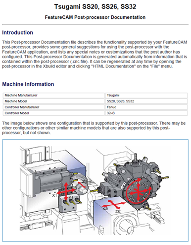

You can create documentation from a CNC file in HTML to make it more understandable and to help when comparing and keeping a record of CNC files.
This is an example HTML output using a template:
Creating HTML documentation
