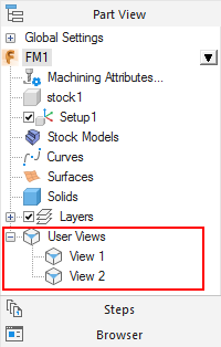

To save a user view
Click View tab > Views panel > Save to create a custom view of your model. The new view is added to the User Views node of the Part View panel.
To activate a user view
Double-click a user view in the Part View panel to use this view in the graphics window.
To rename a user view
  1. Right-click a user view in the Part View panel and choose Rename.
  2. Enter a new name.
  3. Click OK.
To delete a user view
Right-click a user view in the Part View panel and choose Delete.
