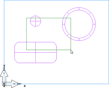

Select Partial
This method enables you to box select multiple objects without fully enclosing them.
In the example below, all three features are selected:

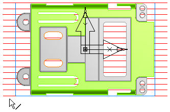

For example, if you use the Select by Color/Type dialog, you can select either the green lines or the gray lines, but not both at the same time.

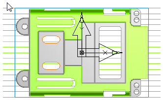

If you use the Select button for a box selection of lines in a front view, you cannot select the lines without selecting some of the surfaces too:

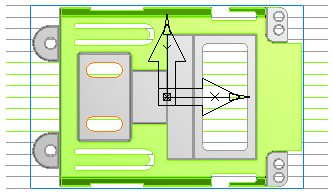

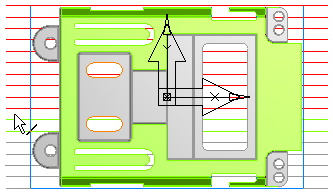

Using the Drag Select option, you can drag the mouse pointer over the lines to the left of the stock to select them all:
Drag Select can save time when selecting adjacent surfaces. With the standard Select mode, to select adjacent surfaces, you must use a box-select or Ctrl+click each surface. With Drag Select, just move the mouse pointer over adjacent surfaces. You can hold down the Ctrl key with Drag Select to add non-adjacent surfaces to the selection, or after you have released the mouse button, for example to change the view of the part.
