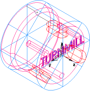

This shows you how to add three milled slots to the part.
Create a Slot feature:
  1. Select Home tab > Part Program panel > Features.
  2. In the New Feature wizard, select the Turn/Mill option, and click Next.
  3. In the From Dimensions section, select Slot.
    Select Make a pattern from this feature, and click Next.
  4. On the Dimensions page:
    Enter a Length of 1.0.
    Enter a Width of 0.5.
    Enter a Depth of 0.25.
    Click Next.
  5. On the Patterns page select Radial around index axis, and click Next.
  6. On the Location page:
    Enter a B Angle of 90.
    Enter a Radius of 1.25.
    Enter a Z to 0.25.
    Click Next.
  7. On the Dimension page:
    Enter a Number of 3.
    Enter a Spacing Angle of 120.
  8. Click Finish.
