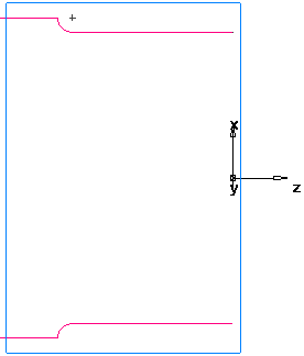

This shows you how to add Holes to the face of the part.
  1. Select View tab > Appearance panel > Line Display menu > Turning 2D View to switch to a simplified 2D representation of the part.
  2. Create a Hole.
    1. Select Home tab > Part Program panel > Features.
    2. In the New Feature wizard, select the Turn/Mill option, and click Next.
    3. In the From Dimensions field, select Hole and click Next.
    4. In the Dimensions dialog:
      Enter a Chamfer of 0.0.
      Enter a Depth of 1.0.
      Enter a Diameter of 0.25.
    5. Click Finish and Create More.
  3. Create a Pattern from feature:
    1. In the New Feature wizard, select the Turn/Mill option, and click Next.
    2. In the From Feature field, select Pattern, and click Next.
    3. Select the hole you just created and click Next.
    4. Select Radial in the setup XY plane, and click Next.
    5. On the Pattern - Dimensions page:
      Enter a Number of 3.0.
      Enter a Diameter of 2.0.
      Enter a Spacing Angle of 120.
      Enter an Angle of 60.
    6. Click Finish.
    7. Click Cancel.
  4. View the 3D wireframe representation of the part:
    1. Deselect View tab > Appearance panel > Line Display menu > Turning 2D View to return to a 3D view of the model.
    2. Click View tab > Views panel > ISO menu > ISO 1.
