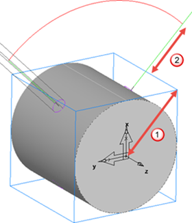

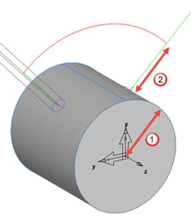

    Calculate index radius from solid stock outline
    Calculate index radius from solid stock outline off:
    Calculate index radius from solid stock outline on:
    — Distance to bounding box
    — Z rapid level attribute value
    — Distance to stock boundary
