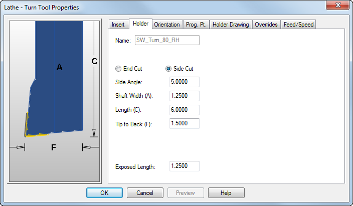

Click the tool preview image to pan and zoom it. The orientation of the preview is determined by the settings on the Options > View > Machine page. Right-click the image to access a context menu.
Name — Specifies the name of the current tool.
Note: To edit the
Name of the tool, use the
Insert/Type tab.
End Cut — The tool cuts in a direction parallel with the length of the holder.
Side Cut — The tool cuts in a direction perpendicular with the length of the holder.
Exposed length — This is the amount of the tool that sticks out of the holder if the holder is simulated.
End angle
End clearance
Side angle
Side clearance
