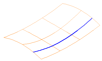

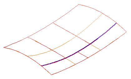

    A subregion of a surface is sometimes necessary for an auxiliary surface to use for surface/surface intersection, filleting, milling, and so on. Split is an exact operation within the limits of the original surface.
    Splitting the top surface of the soap dish model creates two surfaces. The pictures show a split along a column of the surface.
