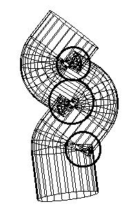

Troubleshooting swept solids
If you use a cross section that is too large, it can result in surfaces that self-intersect. If sweeping from both ends of the curve does not work, cancel the swept solid and try creating a swept surface. If the result shows overlapping surface regions like shown below, then the cross section is too large.
