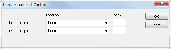

Transfer Tool Post Control dialog
Use this dialog to set the Location and Index that you want to use for each tool post on your machine during part handling.
Location — Select where you want the tool post to be during the part handling:
  • None — Select this option to leave the tool post at its current position before starting the part handling.
  • Home — Select this option to move the tool post to its home position before starting the part handling.
  • Escape — Select this option to move the tool post to a safe location away from the part before starting the part handling.
Index — If necessary, you can rotate the tool post to ensure that tools are not in the way. Enter the Index number.
