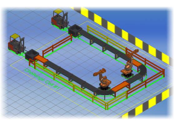

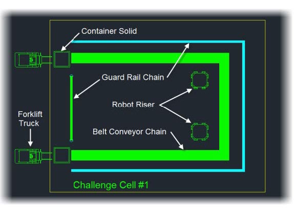

Exercise Challenge 1
  1. Open AutoCAD.
  2. Open the exercise file in FDU Tutorial > Tutorial 1-3 > Challenge Cell #1.dwg.

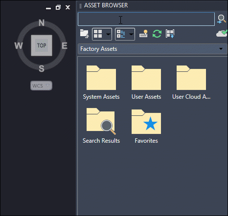

  3. In the Asset Browser Search bar, locate the following assets:
  • Belt Conveyor (Chain)
  • Guard Rail (Chain)
  • Robot Riser (Cloud Asset)
  • Container Solid
  • Forklift Truck
  1. To download the searched assets for use, select the asset thumbnail image in the Asset Browser and Select Download from the right-click context menu.
  1. Place the assets on your new layout as shown in the following image.
  1. Open the layout in Inventor and place the TD_Arm Welding Clamp 48 robots you used in the previous tutorial onto the risers as shown in the following image.
  1. Open the 3D layout again in AutoCAD to update all the drawings.

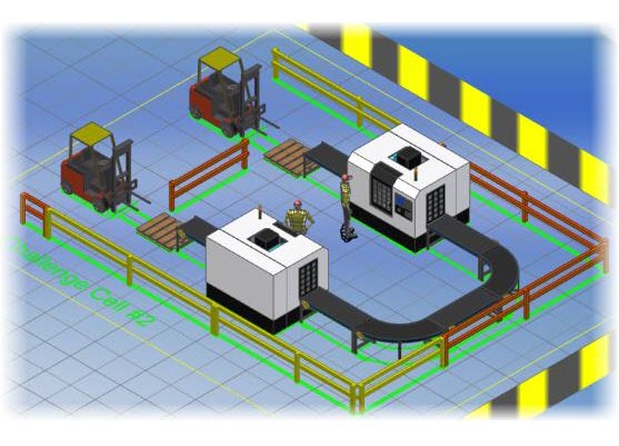

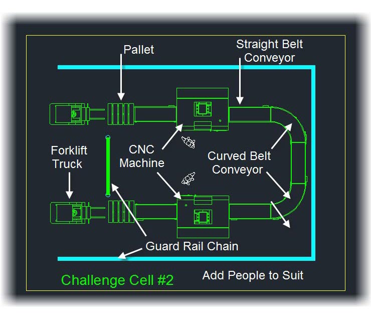

Exercise Challenge 2
  1. Open AutoCAD.
  2. Open the exercise file in FDU Tutorial > Tutorial 1-3 > Challenge Cell #2.dwg.
  3. In the Asset Browser Search bar, locate the following assets and Download them for use.
Note: See step 4 in preceding Exercise Challenge 1 for instructions on how to download assets from the Asset Browser.
  • Straight Belt Conveyor
  • Curved Belt Conveyor
  • CNC Machine
  • Pallet
  • Forklift Truck
  • Man
  1. Open the layout in Inventor and place any additional assets as necessary.
  1. Open the Inventor layout again in AutoCAD to update all the drawings.
