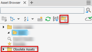

In the Asset Browser, navigate to the asset you want to designate as obsolete.
Right-click and then select Obsolete.
The asset is added to the Obsolete Assets Folder and the Show/Hide Obsolete Assets Folder button is enabled.

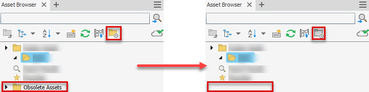

Click the Show/Hide Obsolete Assets Folder button to hide the Obsolete Assets Folder from the Asset Browser.
The Obsolete Assets Folder is hidden now and its contents do not appear in search results.
