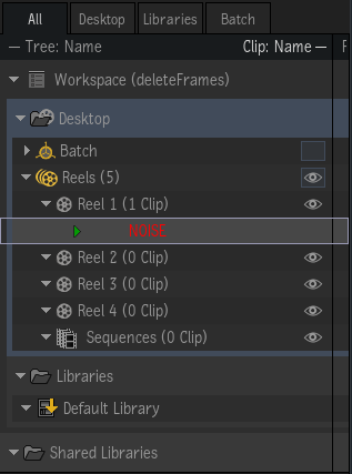

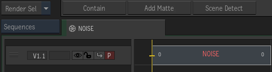

vic also flags segment and clips with missing frames. In Flame, segments with missing frames have their name written in red. Clips with segments that are missing frames also have their name coloured red.
Clip with LOST frame | Segment with LOST frame |
