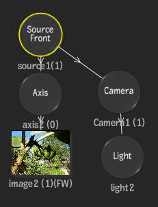

When you create a matte or front source, a new branch appears in the schematic showing the matte or front clip is separated from its media, ultimately replacing the matte or front with itself. This method of using source nodes lets you animate the media's matte or front separately.

    A source node branch is created in Schematic view that parents an axis and a surface, as well as a camera and a light. This light is an ambient type, and appears at half the distance of the source camera.
