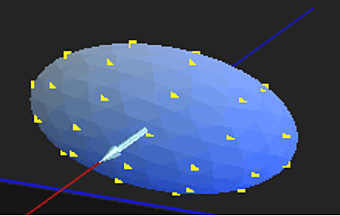

    An arrow appears in the softness ellipsoid, showing the direction in which the softness needs to be increased to reduce graininess in the sampled area.

    • Drag the cursor over the Scaling field to the right. The softness is increased based on the results of the analysis from the grainy region. Observe that the softness ellipsoid is scaled in the direction of the arrow.
